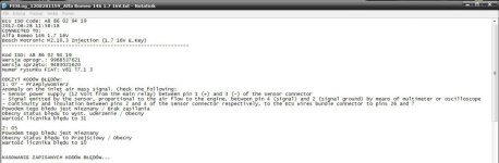

Koledzy, jakie wnioski można wyciągnąć z tego błędu? :)
ODCZYT KODÓW BŁĘDÓW:
1: 07 - Przeplywomierz
Anomaly on the inlet air mass signal. Check the following:
- Sensor power supply (12 Volt from the main relay) between pin 1 (+) and 3 (-) of the sensor connector
- Signal emitted by the sensor, proportional to the air flow to the engine, between pin 4 (signal) and 2 (signal ground) by means of multimeter or oscilloscope
- Continuity and insulation between pins 2 and 4 of the sensor connector respectively, to the ECU wires bundle connector to pins 26 and 7
Powodem tego błedu jest Nieznany / Brak zasilania
Obecny status błędu to Wyst. uderzenie / Obecny
Wartość licznika błędu to 31
