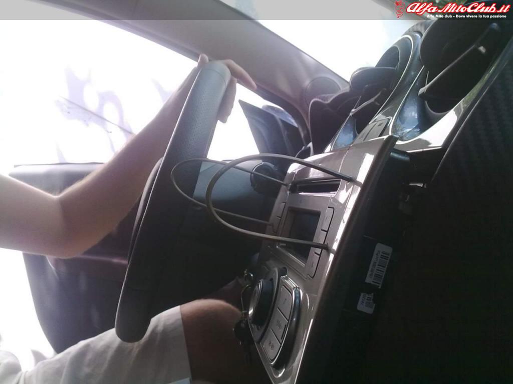

Radio - something like that. Photo borrowed from an Italian forum.

you can buy radio keys on Allegro for 5 zloty + 4 shipping, or the hard way - use nails or wire to unlock the latches, as in the photo and push the radio out from the back after removing the cubby hole (about 10 screws, ~5 minutes of work), nails don’t have burrs which would let you yank the radio out...
